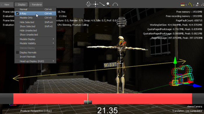

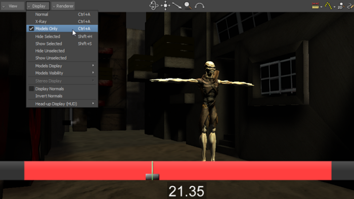

The virtual Render() function is invoked once per frame/per view pane for the selected custom renderer. Upon call, the associated OpenGL context is set up properly. For example, the output frame buffer (color, depth, stencil, and others), GL’s viewport, camera’s project, model-view matrix, and so on. Depending on the current camera’s setting, the target frame buffer might contain the rendering result for the camera’s back plate and grid. You must fill up the output frame buffer with the desirable content (either directly render on the target frame buffer, or only built the final result). Mostly the color buffer output is sufficient, but in certain scenarios it is desirable to have a proper depth buffer output as well. After the Render() function returns, depending on the current display mode and camera setting, MotionBuilder might continue to render the other elements in the viewport including the following:
The following figure shows the Models-Only display mode.
The following figure shows how the X-ray and Normal display mode draw extra elements in the viewport.

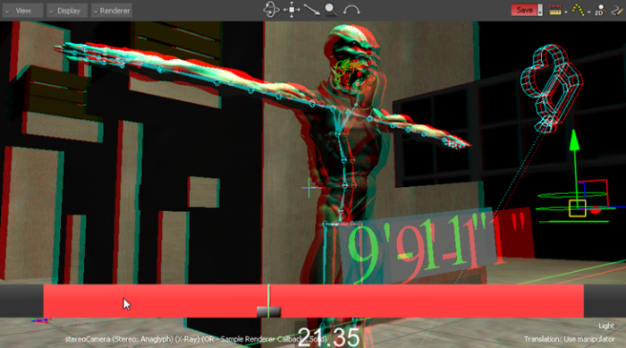

In the stereo display mode, the Render() function is called twice per frame/per view pane (once for the left and right eyes respectively), and composite both the buffers accordingly (if not using the active stereo mode).

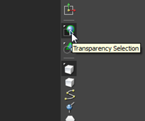

Using these additional properties, MotionBuilder can dynamically adjust its runtime behaviour according to the current choice of renderer. For example, if you set SupportIDBufferPicking to be false, picking in Transparency Selection mode does not work as expected, and instead MotionBuilder performs the default GL selection buffer based picking.
The Transparency Selection mode (as shown in the following figure) works only when the selected custom renderer’s SupportIDBufferPicking property is true.
