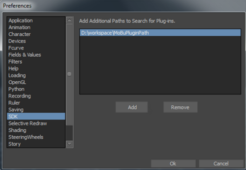

    After the project is built successfully, the resulting library is saved in /bin/x64/plugins. Make sure that you have write access to this folder, or configure the Visual Studio project setting (or Makefile in Linux) and specify the destination folder as one of the additional plug-in directories. You can add additional plug-in paths either by setting the MOTIONBUILDER_PLUGIN_PATH environment variable or by using the Preferences dialog as shown in the following figure.
    The plug-ins that are saved in these specified folders are automatically loaded at startup.

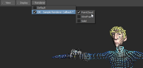

  3. Run MotionBuilder. An additional Renderer menu appears. You can choose a method for rendering the scene as shown in the following figure.
For more information about accessing the custom renderer, see Accessing the Custom Renderer in the User Interface.
