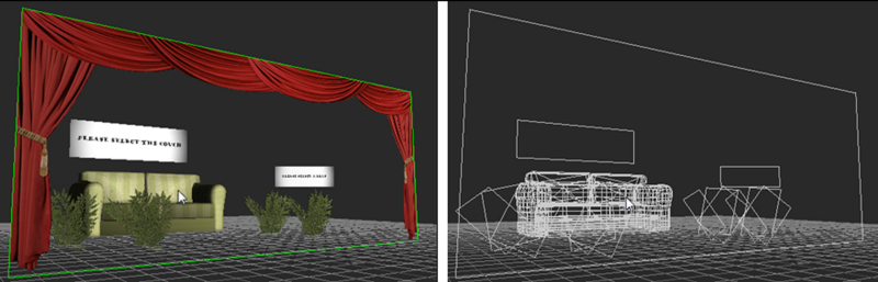

Selection Buffer Picking
MotionBuilder traditionally used the OpenGL selection buffer mode (GL_SELECT mode) as the base technique to implement the viewport selection. However, in this mode, the OpenGL picking pipeline stops after the primitive rasterization stage, and before the pixel shading stage where the alpha channel of models’ mapped texture is accessed to define the transparent regions. Moreover, the picking routine in OpenGL driver might fall back to the CPU approach, which significantly affects the performance for dense geometry.
For more information about the OpenGL selection buffer mode, see http://www.opengl.org/archives/resources/faq/technical/selection.htm.
As shown in the following figure, you cannot pick through the transparent portion of the curtain to select the couch behind it in this mode.

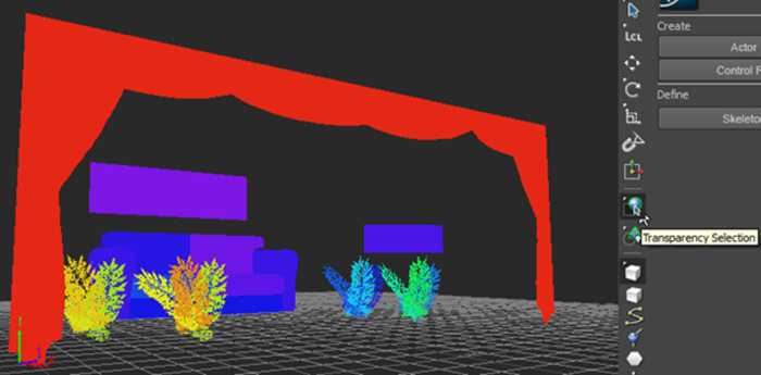

Color Buffer Picking
The new color buffer based picking overcomes the disadvantages mentioned in the
!!CONVERSION WARNING!! broken xref detectd, likely a cross-book reference. The target GUID file is GUID-1C21349C-A4B9-454E-BB9A-CF5689801D03.htm#GUID-ABFE0E2D-3631-4484-84D7-AF6D1B5BAC1A and the target link text is Selection Buffer Picking
section.
The concept is quite simple as follows:
  1. Draw all the visible models with the regular rendering pipeline.
  2. Use the model’s unique ID instead of filling the color buffer with the regular shading result.
  3. Read the pixel value back from the color buffer under the mouse pointer.
  4. Translate it back to the model’s unique ID, and find the corresponding model.
The color buffer filled up with the model's unique ID is shown in the following figure.

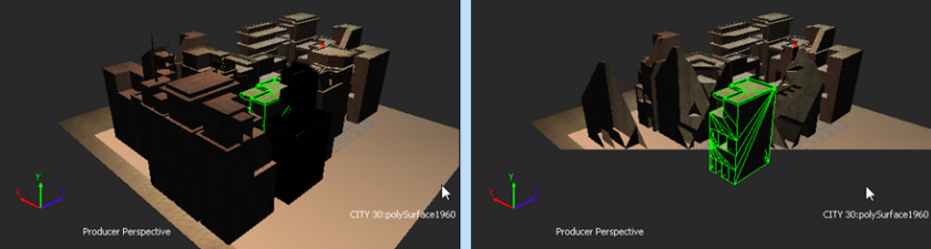

Z Depth Selection
The color buffer selection solved the transparency picking issue effectively. However, you might still face issues in a large and crowded scene that contains many objects. A new selection interaction mode called the Z Depth Selection can select an object, and engage the Hide Front behavior (Shift+1), so you can clearly see the selected object rendered on top of all the other objects. The other objects are culled back to the selected object’s farthest point from the camera. The custom renderer needs to display this effect in the same way as the default renderer.
The following figure shows a scene with a selected object (on the left) and the same scene with the Hide Front behavior (on the right).

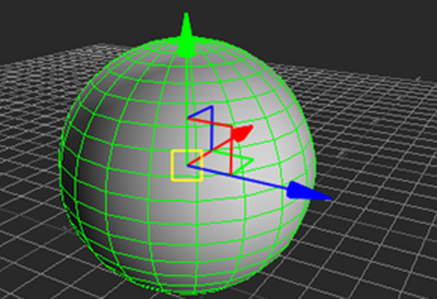

You can change the default selection highlight on a model.
By default, a green wireframe is superimposed over the regular shading on the selected model as shown in the following figure.
However, you can add additional visual hints. For example, bounding box or a semi-transparent color overlay as shown in the following figure.
You can access and modify these setting through the UI (using the property view of the global Renderer object) or through the SDK. You can also remove or replace the default wireframe selection highlight by calling the FBObject_Register() and FBObject_Unregister() functions using the parameters group name render/utilityshader/ogl and entry name SelectionShader respectively.
