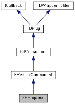

Progress bar.
Definition at line 1950 of file fbcontrols.h.
