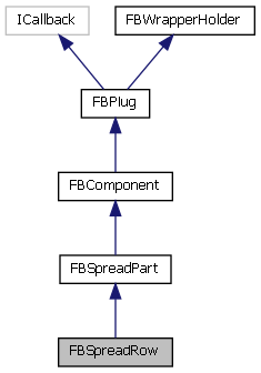

Spreadsheet row.
Definition at line 1477 of file fbcontrols.h.
| FBSpreadRow | ( | FBSpread * | pParent, |
| kReference | pRow | ||
Constructor.
| pParent | Parent spreadsheet. |
| pRow | User-defined reference to assign to row. |
virtual |
Edit the row caption.
This will initiate the UI edit of a row caption.
virtual |
Remove (destroy) row.
| FBPropertyString Caption |
Read Write Property: Caption to display with row.
Definition at line 1495 of file fbcontrols.h.
| FBPropertykReference Parent |
Read Write Property: Parent of row (reference).
Definition at line 1496 of file fbcontrols.h.
| FBPropertyBool RowSelected |
Read Write Property: Is row selected?
Definition at line 1497 of file fbcontrols.h.
