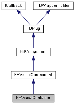

Used to create a container for a tool UI. More...
#include <fbcontrols.h>

Public Member Functions inherited from FBVisualComponent | |

Public Member Functions inherited from FBComponent | |

Public Member Functions inherited from FBWrapperHolder | |
