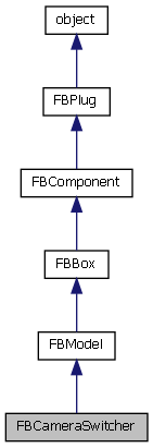

Camera switcher.
This class is a wrapper around the system's camera switcher object. There can only be one switcher in a given scene. Any attempts at creating a new instance will return the existing one.
