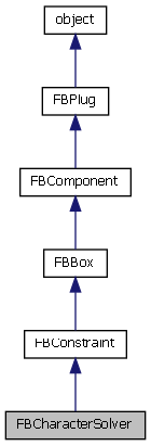

Constraint class. More...

Public Member Functions inherited from FBConstraint | |

Public Member Functions inherited from FBBox | |

Public Member Functions inherited from FBComponent | |

Public Attributes inherited from FBPlug | |

Constraint class.
