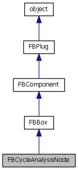

Inheritance diagram for FBCycleAnalysisNode:
