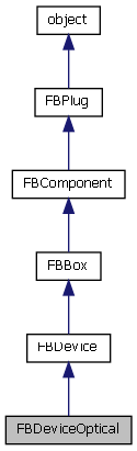

Inheritance diagram for FBDeviceOptical:
