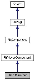

Number edit box. More...

Number edit box.
