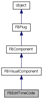

Public Member Functions | |
| FBEditTimeCode () | |
| Constructor. More... | |
Public Member Functions inherited from FBVisualComponent | |
| FBVisualComponent () | |
| bool | AddChild (FBVisualComponent pChild, int pId=0) |
| Add a child component. More... | |
| FBVisualComponent | GetChild (int pId=0) |
