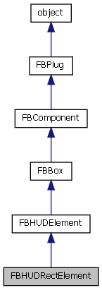

Heads Up display. More...
Public Member Functions | |
| FBHUDRectElement (str pName) | |
| Constructor. More... | |
Public Member Functions inherited from FBBox | |

Public Member Functions inherited from FBComponent | |

Public Attributes inherited from FBHUDElement | |

Public Attributes inherited from FBBox | |

Public Attributes inherited from FBComponent | |

Public Attributes inherited from FBPlug | |
