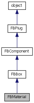

Material class. More...
Inheritance diagram for FBMaterial:
