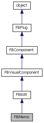

Multi-line text input. More...

| FBMemo | ( | ) |
Constructor.
| GetStrings | ( | FBStringList | pLines | ) |
Get the content of the memo.
| pLines | Content of the memo will be copied to it. |
| SetStrings | ( | FBStringList | pLines | ) |
Set the content of the memo.
| pLines | Content of the memo from will be set to it. |
