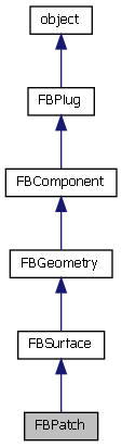

Patch class.
ControlPointsBegin | ( | ) |
Begin control points edition.
ControlPointsEnd | ( | ) |
End control points edition.
SurfaceBegin | ( | ) |
Begin Patch definition.
SurfaceEditBegin | ( | ) |
Begin patch surface edit.
SurfaceEditEnd | ( | ) |
End patch surface edit.
SurfaceEnd | ( | ) |
End Patch definition.
FBSurfaceType USurfaceType |
Read Write Property: Patch mode for U direction.
FBSurfaceType VSurfaceType |
Read Write Property: Patch mode for V direction.
