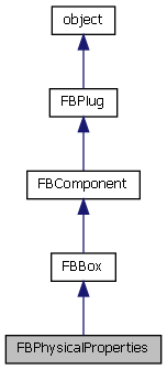

Base class for physical properties attach to a model. More...
