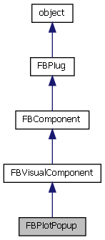

Plot Popup (for setting options only). More...

| FBPlotPopup | ( | ) |
Constructor.
| FBPlotOptions GetPlotOptions | ( | ) |
Get plot options.
| SetPlotOptions | ( | FBPlotOptions | pPlotOptions | ) |
Set plot options.
| pPlotOptions | Set the plot options that will be used when displaying the plot popup. First use the GetPlotOptions(), change the options and use the SetPlotOptions() to set them before calling the Popup() function. |
