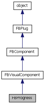

Progress bar.b>Property: Base property class. More...
