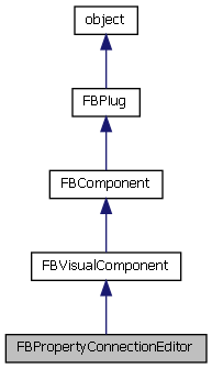

Property Connection Editor. More...
Public Member Functions | |
| FBPropertyConnectionEditor () | |
