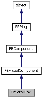

Scroll Box. More...
Public Member Functions | |
| FBScrollBox () | |
| Constructor. More... | |
Public Member Functions inherited from FBVisualComponent | |

Public Member Functions inherited from FBComponent | |

Scroll Box.
This class provides a layout that will be automatically managed with a scrollbar according to the specified width and height. This provides a way to add dynamic UI control.
