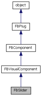

Slider. More...
Public Member Functions | |
| FBSlider () | |
| Constructor. More... | |
Public Member Functions inherited from FBVisualComponent | |

Public Member Functions inherited from FBComponent | |

Public Attributes inherited from FBPlug | |
