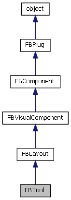

Tool class. More...

Public Member Functions inherited from FBLayout | |

Public Member Functions inherited from FBVisualComponent | |

Public Member Functions inherited from FBComponent | |

Public Attributes inherited from FBPlug | |

Tool class.
See samples: MBFileRefDemo.py, CloseTool.py, MoveResizeToolExample.py, SafeToolCreationExample.py, ToolCommunicationReceiver.py, ToolNativeWidgetHolder.py.
