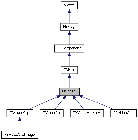

Inheritance diagram for FBVideo:

Detailed Description
Video media class.
Similar to the FBModel class, the FBVideo class serves as a general media class for images, video clips and video memory, as well as the possibility of custom formats and custom live cards.To have a valid FBVideo object, it must be constructed with a string pointing to a valid media file. After the creation, the method 'IsValid()' should be used to confirm the object's status. An invalid object cannot be used or interact with any other application object. The only property that can be read and modified is its 'Filename'. To make convert an invalid FBVideo object into a valid one, simply change its Filename property to point to a supported media file.
See sample: DeleteUnusedMedia.py.
◆ FBVideo()
FBVideo ( str  pName)
Constructor.
Parameters
pNameName of video media.
Warning
The pName parameter must point to a valid media file, otherwise the object will not be valid. Use the method 'IsValid()' to confirm the object status.
