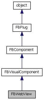

Web viewer. More...
Public Member Functions | |
| FBWebView () | |
| Constructor. More... | |
| Load (str pURL) | |
| Load the specified Url. More... | |
Public Member Functions inherited from FBVisualComponent | |
| FBVisualComponent () | |

Public Member Functions inherited from FBComponent | |
| FBComponent () | |
