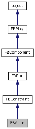

FBActor is used to link motion data to a character. More...
Inheritance diagram for FBActor:
