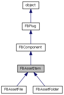

Base class for all managed assets. More...
