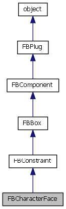

Animates a character face using an actor as input. More...
