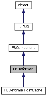

Base Model deformer class. More...
Public Member Functions | |
