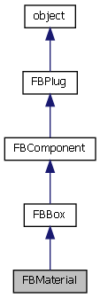

Material class. More...

Material class.
See samples: MaterialAndTexture.py, TextureAnimation.py, VideoInput.py, VideoMemory.py.
