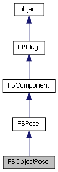

FBObjectPose class. More...
Public Member Functions | |
