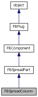

Spreadsheet column. More...

Spreadsheet column.
| FBSpreadColumn | ( | FBSpread | pParent, |
| int | pCol | ||
Constructor.
| pParent | Parent spreadsheet. |
| pCol | Column number. |
| str Caption |
Read Write Property: Caption of the column.
| FBTextJustify Justify |
Read Write Property: Text justification.
| int Width |
Read Write Property: Column width.
