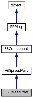

Spreadsheet row. More...

Public Member Functions inherited from FBComponent | |

Public Attributes inherited from FBSpreadPart | |

Public Attributes inherited from FBComponent | |

Public Attributes inherited from FBPlug | |
