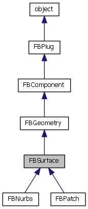

Surface class. More...
Inheritance diagram for FBSurface:

Detailed Description
Surface class.
◆ FBSurface()
FBSurface ( str  pName)
Constructor.
Parameters
pNameName of Surface.
