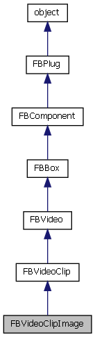

| FBVideoClipImage | ( | str | pName | ) |
Constructor.
| pName | Name of image file. |
| bool ImageSequence |
Read Write Property: Clip is an image sequence?
| FBVideoResolution MaxMipMapResolution |
Read Write Property: Maximum MipMap resolution will be loaded into GPU.
| bool UseSystemFrameRate |
Read Write Property: Clip is using system frame rate?
