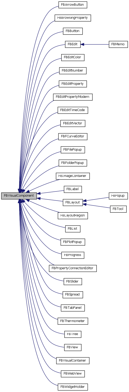

Inheritance diagram for FBVisualComponent:

All of the user interface elements available in the SDK derive from this class.
