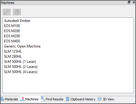

Machines
The Machines window lists all machines from Netfabb. New machines have to be added in the parent application (Netfabb Ultimate), but it is possible to edit machine specific properties by double-clicking a machine name or selecting a machine and clicking the pencil button.
