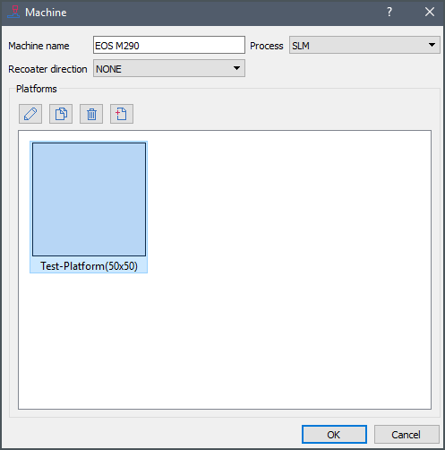

Machine Configuration
Process and Recoater Direction are optional values that can be accessed from within the buildstyle scripts. Machine platform configurations are more important, because a platform specification is mandatory for creating a test build. Use the Insert, Edit, and Delete to add, modify, or remove platforms.
