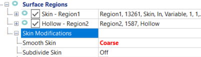

  2. In the Surface Regions tree under Skin Modifications, set Smooth Skin to Coarse.

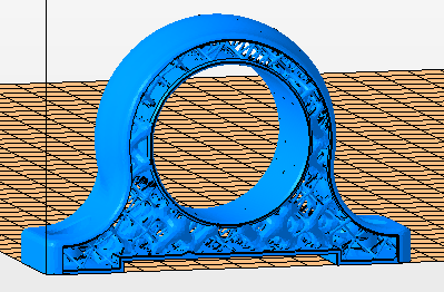

  5. In Netfabb, right-click the part and select Prepare > Run Repair Script..
  6. In the Automatic Repair dialog, select Extended Repair, then click Execute.
    Doing this should repair both skin and lattice meshes.
