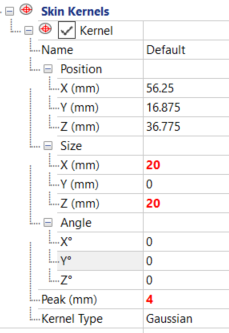

  1. Expand the Skin Kernels tree, and in the first kernel, try the following values, but you may need to modify them for the position of your model:
    • Position: use default X, Y, and Z values to place the kernel at the center of the large hole.
    • Size: 20, 0, 20
    • Peak: 4
    • Kernel Type: Gaussian

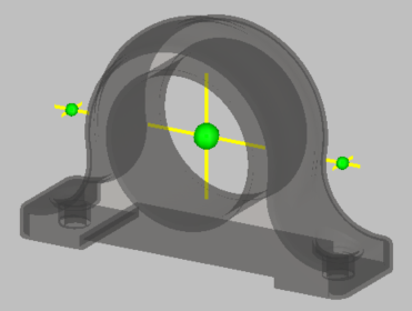

    If you click Skin Kernels, you should see all three skin kernels, with the smaller side ones aligned in a horizontal plane, and the large center one oriented vertically.
    Feel free to adjust Position values if the kernels do not appear to be symmetrically placed.
