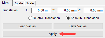

  3. In the Toolbar, click the Move icon , and translate the part to the platform origin. You can do this in the Move dialog as follows:
    1. Click Absolute Translation, and then set Translation values for X, Y, and Z all to 0.00.
    2. Click the Apply button.
    The part should align with its corner on the edge of the platform.

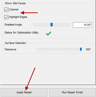

  4. In the Toolbar, click Repair Part .
  5. In the Properties Panel, click the View tab, and under Show Slim Faces, select Colored and Highlight Edges.
    You should see a green check mark, indicating that the mesh is ready for the Optimization Utility.
  6. Click Apply Repair, and then in the Apply Repair dialog, click Remove old Part.
