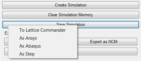

  2. Transfer the generated topology through Structure n > Save Simulation > To Lattice Commander.
