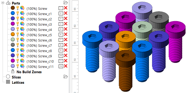

Display colors represented in the project tree and in the display

Whenever a new or a replacement part or slice stack enters Netfabb, it gets assigned a color from a rotating color list.
Example cases that add parts or slices
In particular, the last two operations apply the same display color to the conversion results as the conversion sources had.
