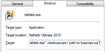

To run a Lua script when launching
Netfabb
A command-line option allows running a Lua script in
Netfabb when you launch it.
- Navigate to the installation folder of
Netfabb, typically
C:\Program Files\Autodesk\Netfabb Ultimate 2019\.
- Find the
netfabb.exe executable and create a shortcut to it.
- Edit the shortcut and add
"/startluascript=path\to\luascript.lua" to what is already specified in the
Target: field, adjusted for your Lua script file's respective path and name.
- Click
Apply.
With a shortcut provisioned like this, you can have
Netfabb load a Lua script right at launch.
Note: You cannot provide start parameters for the script itself similar to how you would call the Lua interpreter with the script name and start parameters for that script. Instead, you will have to use different means to communicate the startup parameters, such as by writing a file, for example. For a working example for this visit
this response in the Netfabb forum.
