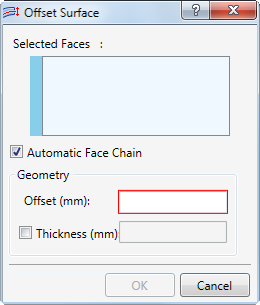

- Click
Autodesk Inventor Nastran ribbon
Prepare
Offset Surfaces. The Offset Surface dialog appears:
- If you want to select a continuous chain of tangent faces with a single click, leave the
Automatic Face Chain option activated. If you only want to select the individual faces you directly click, deactivate the
Automatic Face Chain option.
- In the model canvas, click the faces that you want to offset and use as the basis of the shell element representation. Each clicked face is listed in the
Selected Faces box (along with all tangent if the Automatic Face Chain option is activated). You cannot select faces of two parts in the same Offset Surfaces instance. Therefore, you need to undividually execute the Offset Surfaces command for each part that you want to convert to a surface representation.
- Optionally, to revise the selection set, select and right-click one or more items in the Selected Faces list. From the context menu, you can:
Delete the selected items, or
Clear All items from the list.
- Enter the desired
Offset distance. A positive offset moves the surface into the solid body to which the face belongs. A negative offset moves the surface away from the solid body.
- Optionally, activate the
Thickness option and enter a user-specified thickness value. The default value is twice the offset distance.
Since the default Thickness = 2 * Offset, the default thickness will be negative if you specify a negative offset value. In such cases, be sure to override the
Thickness and enter an appropriate positive value.
- Click
OK to complete or
Cancel to abort the operation. The solid body associated with the selected faces is suppressed and replaced by an offset surface representation. The new Offset Surface is listed in the
Idealizations\Shells branch of the model tree.

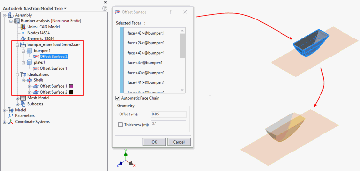

In the following example, the "plate" part had been converted previously to a surface representation, and the "bumper" part is now being converted too. The Automatic Face Chain option is active, allowing all outer surfaces of the solid to be selected in a single click:
