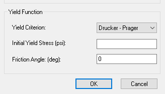

Elasto-Plastic (Bi-Linear) option under
Type. The following window pops up:

- Four types of
Yield Criterion are available. Various extra input data are required from you:
von Mises: This is most widely used for ductile materials.
- Requires
Initial Yield Stress value.
Tresca: Also applicable to ductile materials in general, but more conservative than von Mises.
- Also needs
Mohr-Coulomb: This theory is applicable to frictional materials like soil and concrete.
- Requires a
2*Cohesion value, in units of stress.
- Requires a
Friction Angle value, 0<Φ<45 in degrees, default zero.
Drucker-Prager: An approximation to the
Mohr-Coulomb theory, it is a modification to the
von Mises theory. Also applicable to frictional materials like soil and concrete.
- Requires a
- Requires a
Initial Yield Stress: This value also has a default value which is extracted from the material library data for each selected material. It has other defaults if the material is not loaded from a library.
- Specific to Explicit analysis:
- Requires
- Requires a
Friction Angle value, in degrees, default zero.
