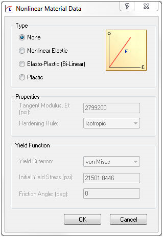

Click the Nonlinear button in the Analysis Specific Data section of the Material form. The following window pops up:
There are four options supported in the Nonlinear Material Data:
None: For Linear Elastic material, which is the default, as shown in the above figure.
Nonlinear Elastic: For Nonlinear Elastic material.
Elasto-Plastic (Bi-Linear): For Elasto-Plastic type material.
Plastic: For Plastic type material.
