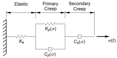

represent parameters of the uniaxial rheological model as shown in the following figure.

Figure 1. CREEP Parameter Idealization

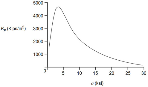

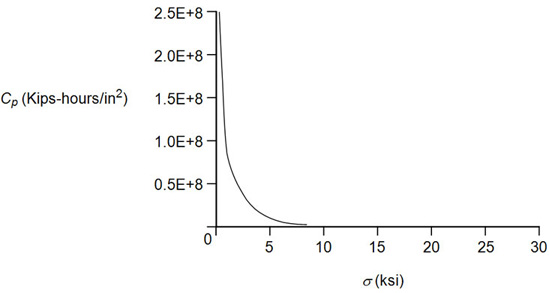

Creep model parameters, as shown in the figures below, must have positive values. If the table look-up results in a negative value, the value will be reset to zero and a warning message will be issued.
Figure 2. K p Versus σ Example for CREEP

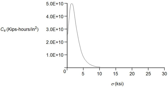

Figure 3. C p Versus σ Example for CREEP
Figure 4. C s Versus σ Example for CREEP
