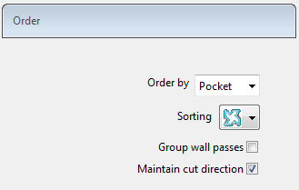

Order (PartMaker, advanced pocket milling)
Use the Order page to control the order of machining.
Order by — Select whether machining takes place by Level or by Pocket.
Sorting — Select an option to specify the machining order for areas on the same level.
Group wall passes — Select to machine all wall passes, of different levels, at the end.
Maintain cut direction — Select this option to maintain the Cut direction specified on the main page. Deselect this option to let PartMaker create a toolpath with fewer tool lifts. PartMaker adheres to the specified cut direction as far as possible, but priority is given to fewer tool lifts.
