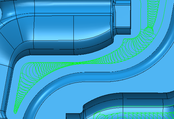

Using a Radius of 0.2 produces:
Using a Radius of 0.05 produces:
You can see that a small Radius value produces more trochoids.
Note: Small trochoids are inadvisable, if possible keep the trochoids larger than 1 mm.
